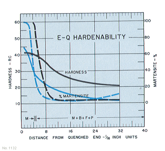

86B20 Steel
Steel name: 86B20
Diagram No.: 1132
AISI/SAE designation: 86B20
Chemical composition in weight %: Black lines: 0.18% C, 0.83% Mn, 0.49% Ni, 0.49% Cr,
0.19% Mo, 0.0013% B. Blue lines: 0.18% C, 0.79% Mn, 0.52% Ni, 0.56% Cr, 0.19% Mo, B-none
Steel group: Boron steels
Comment: Diagram: M-Martensite, B-Bainte, F-Ferrite, P-Pearlite, E-Q (E ND Q) hardenability (Jominy)
Austenitizing temperature: Black lines: 1700oF, grain size: 6-7. Blue lines: 1650oF, grain size: 9-10.
