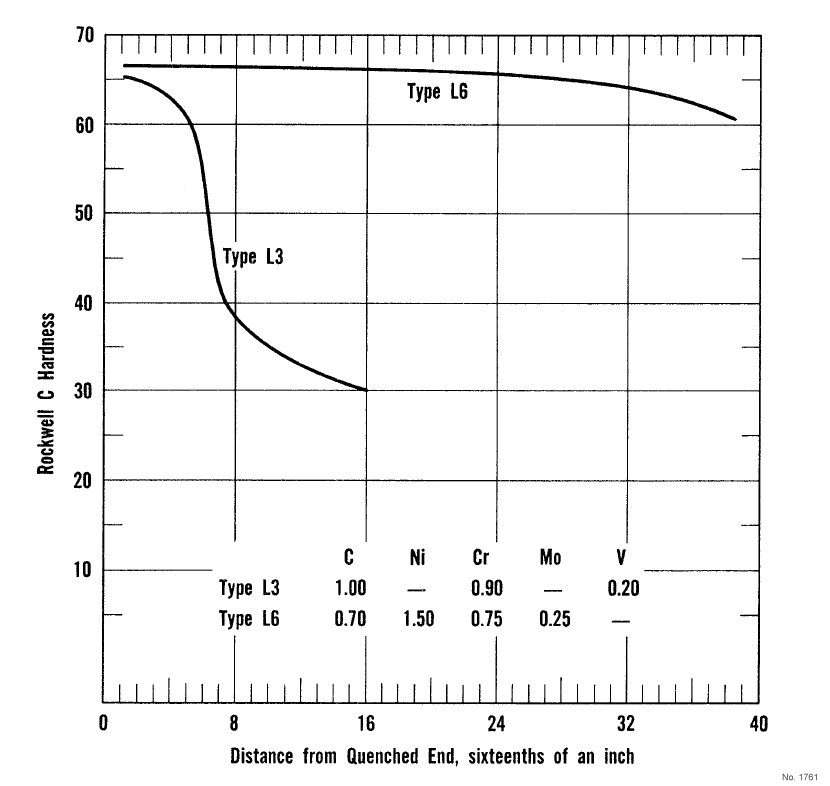

L3, L6 Steels
Steel name: L3, L6
Diagram No.: 1761
AISI/SAE designation: L3, L6
Chemical composition in weight %: L3 steels: 1.00% C, 0.90% Cr, 0.20% V. L6 steel: 0.70% C, 0.75% Cr, 1.50% Ni, 0.25% Mo.
Steel group: Tool steels
Comment: No data
Normalized at: 1750 F
End quenching temperature: 1650 F
