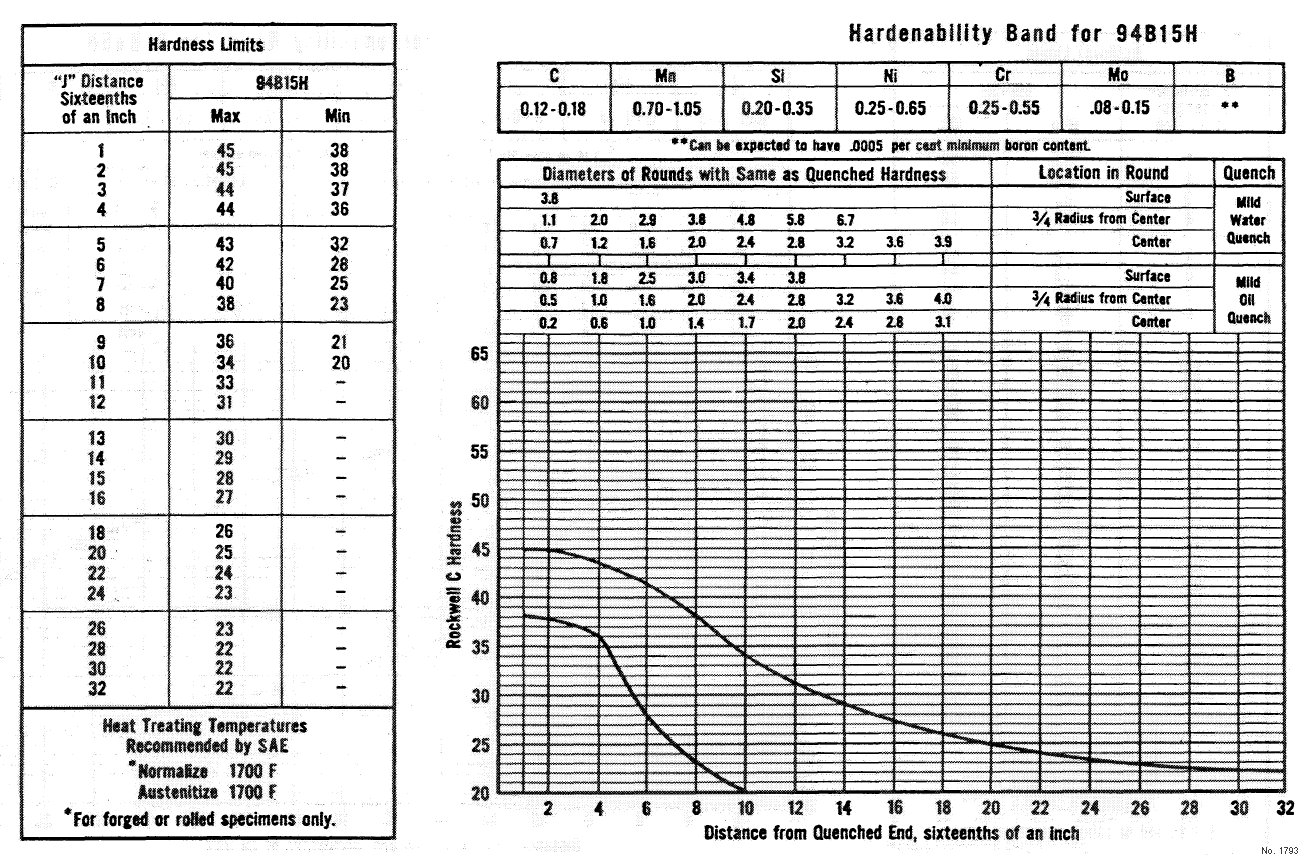

94B15 H Steel
Steel name: 94B15 H
Diagram No.: 1793
AISI/SAE designation: 94B15 H
Chemical composition in weight %: 0.12-0.18% C, 0.20-0.35% Si, 0.70-1.05% Mn, 0.25-0.55% Cr, 0.25-0.65% Ni, 0.08-0.15% Mo, +B
Steel group: Alloy steels, nickel alloy steels, boron steels
Comment: No data
