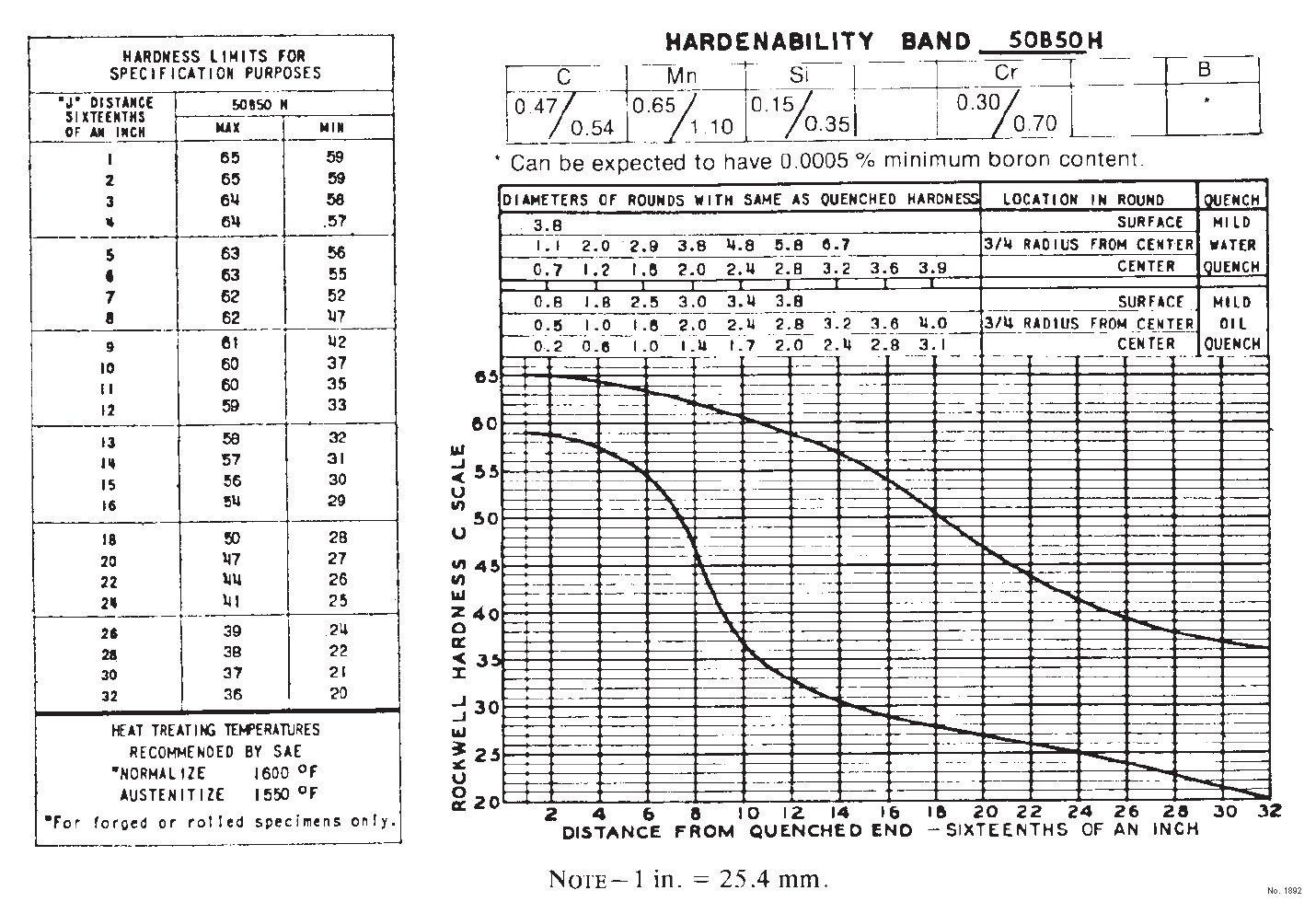

50B50 H Steel
Steel name: 50B50 H
Diagram No.: 1892
AISI/SAE designation: 50B50 H
Chemical composition in weight %: 0.47-0.54% C, 0.15-0.35% Si, 0.65-1.10% Mn, 0.30-0.70% Cr, + B
Steel group: Alloy steels, boron steels
Comment: No data
