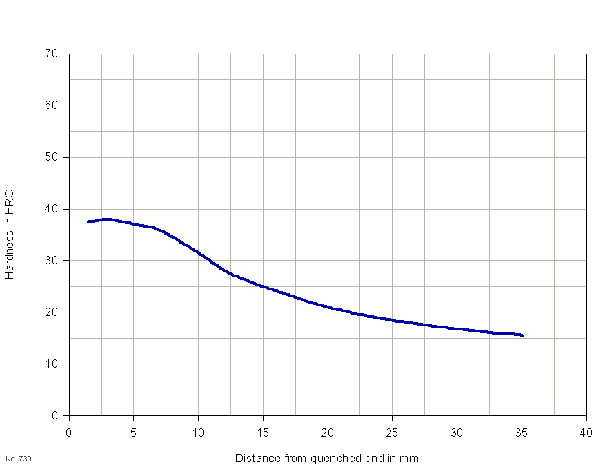

10MnB6 Steel
Steel name: 10MnB6
Diagram No.: 730
Mat.No. (Wr.Nr.) designation: 1.1109
Chemical composition in weight %: 0.10% C, 1.50% Mn, 0.03% S, + B, Ti
Steel group: Boron steel
Comment: The legend: Harte in HRC - Hardness in HRC, Stirnflacheabstand in mm - Distance from quenched end in mm.
Hardening: No data
End quench test: 950oC
