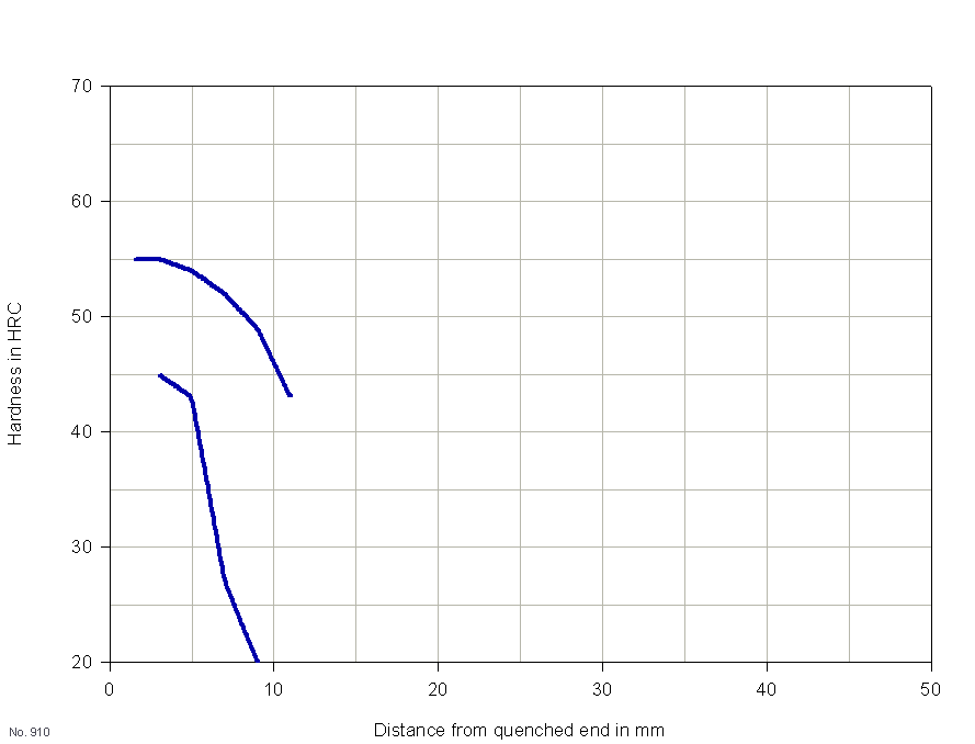

33B2 Steel
Steel name: 33B2
Diagram No.: 910
DIN designation: 33B2
Mat.No. (Wr.Nr.) designation: 1.5514
Chemical composition in weight %: 0.30-0.35% C, 0.30% Si, 0.60-0.90% Mn, max. 0.025% P, max. 0.025% S, 0.30% Cr, 0.25% Cu, 0.0008-0.050% B
Steel group: Alloy special structural steels, boron steels
Comment: No data
Hardening: 865-875oC
End quench test: 865-875oC
