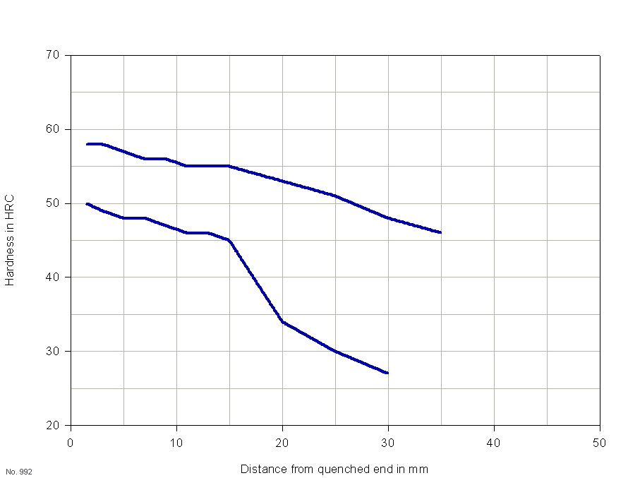

36CrB4 Steel
Steel name: 36CrB4
Diagram No.: 992
DIN designation: 36CrB4
Mat.No. (Wr.Nr.) designation: 1.7077
Chemical composition in weight %: 0.34-0.38% C, 0.30% Si, 0.70-1.00% Mn, max. 0.025% P, max. 0.025% S, 0.90-1.20% Cr, max. 0.25% Cu, 0.0008-0.0050% B
Steel group: Alloy special structural steels, boron steels
Comment: No data
Hardening: 845-855oC
End quench test: 845-855oC
